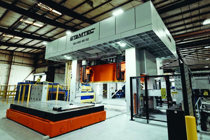

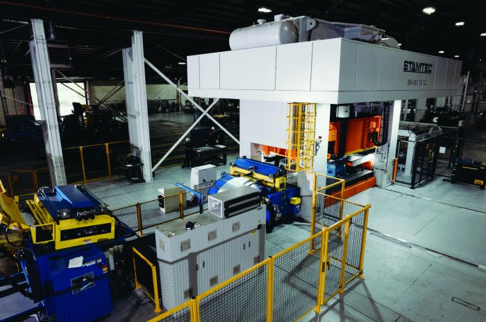

steel fillerThe 660-U.S.-ton eccentric-drive press, with 40-ton-capacity rolling bolster, spearheads the new blanking line at Olympic Steel’s Winder facility. Its fabricated steel-frame structure members—crown, uprights and bed—are of a heavy, box-type construction, stress-relieved before machining. The bed is built to a standard of no more than 0.0015-in. deflection/ft. of bed length left to right and front to back, according to Stamtec regional sales manager Todd Helms, with the full-capacity load symmetrically distributed over two-thirds of the bed area. Eight full-length 90-deg. gibs guide the path of the slide. Other features include a high-torque low-inertia wet clutch/brake; dual-valve automatic hydraulic-overload protection system; herringbone gears, which provide quiet and smooth operation at higher speeds; and digital die-height indicator.
Included is a Wintriss SmartPac Pro press control (eight programmable limit switches and eight die-protection inputs), with WPC2000 clutch-brake control and AutoSetPac four-channel tonnage monitor, along with Wintriss Shadow 9 light curtains.

The new Stamtec press isn’t the only focus. The Verson recently has benefited from the addition of a quick die-change cart that helps cut die-change times by half, or better, says Hall. The Stamtec has a rolling bolster that allows for die changes to be managed by an overhead crane. The rolling bolster, per Stamtec specs, provides 40-ton capacity, 196 in. of travel and 39 ft./min. maximum travel speed. It’s equipped with wipers for removing slugs and foreign objects from the carriage rails as it moves in and out of the press.
