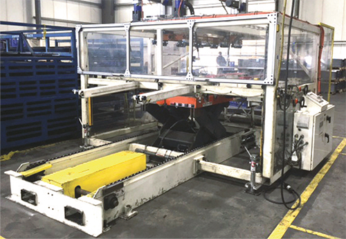

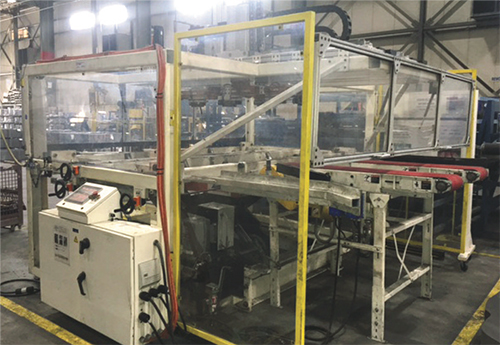

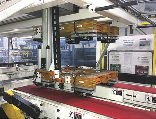

To arrive at the final system setup took some customization, says Billingsley. “When the conveyor was originally built, it was a solid shaft that ran both belts at the same speed using one drive,” he says. “Before we put it into production, we saw that the parts exited at as much as a 45-deg. angle, so we split and modified the conveyor and added a second drive to change the speed in order to rotate the parts into proper position for stacking.”

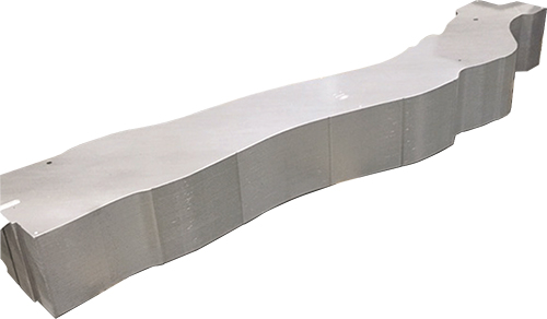

“The angled exiting of parts is necessary because the exit end of the press measures 75 in. wide and the feed-line width is limited to 72 in.,” explains Cousineau. “Because some of these blanks are up to 97 in. long, the strip layout and dies had to be designed at an angle in order for the blanks to properly exit the press.”
Further, to address tailout issues without interrupting part flow, telescopic arms were added to carry the tail past the part stack before placing it on the floor, says Cousineau. “Our challenge,” he says, “was how to get that tail through the machine without hurting parts flow, and without moving the machine away from our press to ensure that alignment stays true.”

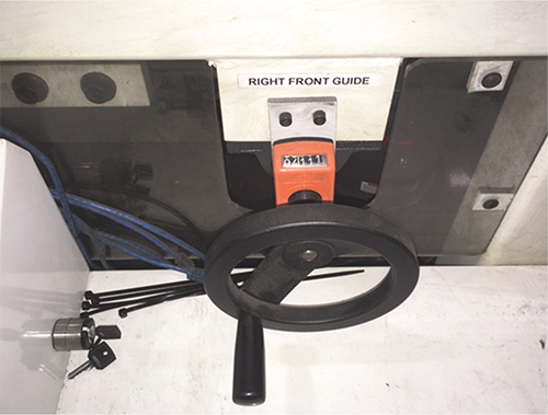

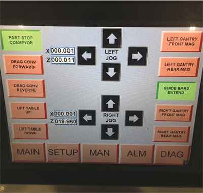

“Our average changeover time decreased 40 minutes,” says Cousineau, “and that includes locating the stacker in place on the press, selecting the program and adjusting hard stops.” Another tangible effect of these efforts, says Cousineau, is the painted targets on back of the press, “so that when workers are placing the stacker, they just line it up according to the target, so they know exactly where to set it.”
