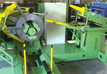

The most common configuration of a compact line, the reel feeder-straightener, gets the call when material is not excessively thick and marking of the coil OD is surface critical. A cradle is not a good choice for stampers running very thin material, say 0.016 in. thick, or narrow-width coils. Processing a lot of partial-run coils also sets the stage for using a reel, which makes rewinding the partial coil a simple task provided it’s equipped with proper coil-holddown arms. Holddown arms also keep the coil tight while rewinding, a difficult if not impossible task to accomplish with a cradle. And, stampers that run dies off center also opt for a reel, since most cradles are self-centering with little provision for off-center movement.
Having selected a reel setup, now the stamper must choose between a single- or dual-reel installation. A dual-reel system requires room on the plant floor to allow the decoilers to swing out. A single-reel setup with a coil car requires less floor space, and our studies indicate that stampers will experience little difference in coil-change time between a dual-reel setup and a single reel with coil car.

To provide sufficient power to decoil and rewind on a reel, the unit typically must include a hydraulic or a variable-frequency drive. Also, to provide enough power to expand the mandrel on the coil ID, metalformers can opt for a hydraulic-expansion feature. Mechanically, expansion is best accomplished with the use of wedges; however, this limits the expansion range. For lighter-weight coils, a linkage mechanism offers greater range but is not as robust.

With this style of feed line the metalformer obtains some level of automation, along with manual coil centering and setting of coil-keeper location. Consider the addition of a coil car to assist with locating the coil on the mandrel, which will quicken coil changes and prevent damage to the coil during loading.

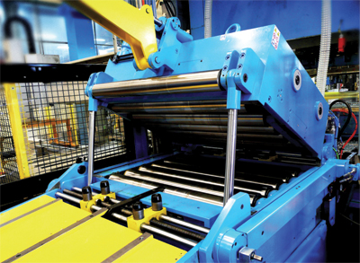

With the method of decoiling selected, let’s focus on the feeder/straightener-head features. Metalformers select from two basic straightener-head designs—one uses individual roll adjustment for bending the material between two opposing rolls, the other employs a bank-adjustable setup.

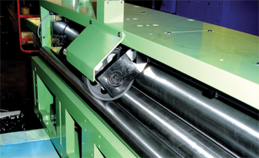

A bank-adjustable straightener head yields optimum flatness results. With a bank adjustment versus an individual-roll-adjusted straightener, the rolls can have a smaller diameter and be spaced more closely together. This setup bends the material more tightly around the roll radius. Also, a bank-adjustment design requires only two adjustments to the straightener-roll settings—for entry and exit gap.
Typically, the feeder/straightener head performs more work to the material at the entry side then at the exit, with the exit-side gap set at or near the material thickness. As the capacity of the straightener increases, metalformers look to add backup or support rolls to the straightener to prevent the smaller-diameter rolls from deflecting, much like the design of a precision leveler. Also, the more rolls in the bank the better the straightening results. Typical straighteners with individual roll adjust will only include only five or seven rolls. With nine or more rolls, flatness tolerance will improve and, in many cases, material defects such as crossbow can be reduced or eliminated.
To ensure sufficient power to pull the material through the straightener head, the rolls must be driven—ideally all of them, although this greatly increases the cost and complexity of the machine. Therefore, in most cases stampers can get by with a machine with driven bottom rolls.
Other Straightener-Head Features to Consider
1) Straightener-head opening option. With this important option, the head can be opened for easy access to the rolls for cleaning. This proves particularly useful to stampers that switch from forming hot-rolled scaly material to cold-rolled steel or aluminum on the same machine. This feature also eases the task of threading the start of the coil into the straightener-feeder head.
2) An effective peeler/threading table promotes hands-free and safe coil threading into the straightener-feeder head. An extendable peeler tongue will reach the leading edge of the coil to help peel it a from the mandrel, and the threading table pivots up and down to assist in safely moving the coil under the straightening rolls. Also, a coil-break arm on the straightener can help back-break the leading coil edge, if needed.
3) Some compact straightener-feeder heads include a closed-loop measuring wheel that provides feedback to the controller to indicate actual movement of the material, not just roll rotation. This proves useful, for example, should a slug get picked up in the die and the feed rolls slip on the material. Without closed-loop feedback from the measuring wheel, the feeder controller would think that the move had been made, and the die might become damaged. But with closed-loop feedback, the emergency stop can be engaged to prevent die damage.
4) Straightener-roll depth setting. Some machines will only offer mechanical adjustment and dial/pointer indicators for setting roll depth. Others will offer hydraulic motors to make these adjustments, particularly popular with stampers forming thicker, stronger materials. These settings can be saved in memory and the actual settings digitally displayed at the control panel.
5) Material guiding. This feature ensures that material feeds squarely through the straightener. Higher-quality machines will have entry and exit guide rolls, and automated versions of certain machines employ motorized rolls with settings saved for each job.
6) Pass-line height adjustment can be accomplished manually with a crank handle and jack screws—requiring quite an amount of arm power. Or, higher-end machines have hydraulic pass-line adjustment accomplished with the turn of a switch. This parameter can be saved in the control when using automated compact lines.
