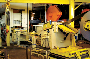

Also critical to its successful implementation of the new lines was a new 12-in. alligator-style peeler that feeds the 110-ton press, to allow for hands-free threading of particularly thick material. Supplied by Coe Press Equipment, Sterling Heights, MI, which modeled the device after similar technology developed several years ago for its large-capacity machines, the new peeler-dekinker provides hands-free motorized threading capability for users of small and mid-sized straighteners. “It allows us to thread up a new coil of that heavy stock in less than 5 min.,” says Williams.
Coe Press also supplied (along with its distributor partner Stafford Machinery Co., Little Rock, AR) identical, more conventional feed lines for the 200- and 600-ton lines that include servo feeds, straighteners, threading reels, and 10,000- and 20,000-lb.-capacity coil cars, respectively. The servo feeds mount to the press and pull material out of a free slack loop. A 42-in. line mounts to the 600-ton press, a 36-in. line to the 200-ton press. Stafford also installed Wintriss SmartPac 2 controls to each new line, with the Wintriss Lets Line Efficiency Tracking Software.

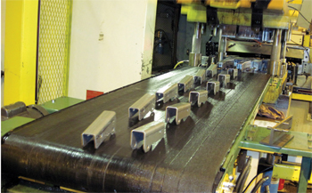

The plant’s new 200-ton press line runs some of the smaller dies needed for its automotive-assembly program, such as the stamped brackets shown exiting here from a two-out die that runs at 50 strokes/min. |

“For example, the biggest challenge we have on the 110-ton press line,” Wells notes, “which runs as quickly as 100 strokes/min., is that we can run through a 6000-lb., 72-in. coil in less than an hour. We’re changing coils as many as 10 times/shift. All of the standard features on the Coe servo-feed lines, as well as the new alligator-style peeler, have helped us fine-tune the coil-change procedure to just 8 to 9 min.”

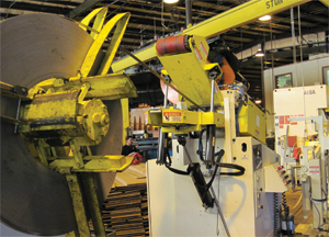

One of the most common jobs running on the 110-ton press is stamping small plates for retail-store customers, from ¼-in.-thick stock 2 in. wide. “We stretched the line out as much as we could,” says Wells, describing efforts to dekink the material, “but we still fought coil set and struggled to get the material into the debend station. Here’s where the alligator-style peeler saved us—it captures the coil and forces it straight into the straightener without having to worry about coil set.”
The two-axis peeler table has a telescoping peeler blade to reach the leading edge of the coil; tapered ends facilitate threading of wide as well as narrow coils. Meanwhile, the upper dekinker table includes a motorized threading roll—during threading, the leading coil edge is pinched between this roll and the peeler table, and then the peeler table lowers to dekink the material.
