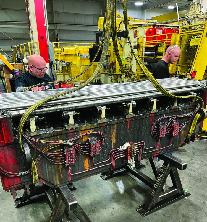

3-Automatic-Feed-Leveler-RebuildNew drive controls provided updated technology for the uncoiler (including tension control), leveler (including loop control) and feeder (including profile feed), exit feed, and scrap chopper. This offered additional line functionality, including coil mapping, fine leveler adjustment, tail-out mode, automatic coil threading, batch part run, microfeeder-sequence mode, sequenced exit-feed scrap-chopper mode and exit-feed shear-speed mode. In addition to updated functionality, the change to AC servo drives provided significant energy savings.
Another benefit of these changes: improved operator safety as the feeder-drive upgrade included a safe-off solution to integrate with a new jog-feed pendant. Plus, features provided with the PLC logic conversion helped reduce setup and changeover time by providing automatic coil load, threading and  tail-out mode, as well as upgraded microfeeder functionality, batch mode and automated machine-function setups. Additionally, the change to a user-friendly HMI, AFCO’s Line Supervisor-AIM, helped automate line setup.
Both of the upgrade projects only amounted to about 40 percent of the cost of a new line investment. Amortized over 24 yr., the total annual capital expenditure would be minimal.
