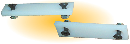

Insufficient support and leveling of pans—Be sure to install pans level with the press bed. Inclining or declining pans can add unwanted torque to the motor, creating excess wear. To better support pans and reduce friction from metal-on-metal contact, ultra-high-molecular-weight (UHMW) polyethylene pads or lining can be used.
