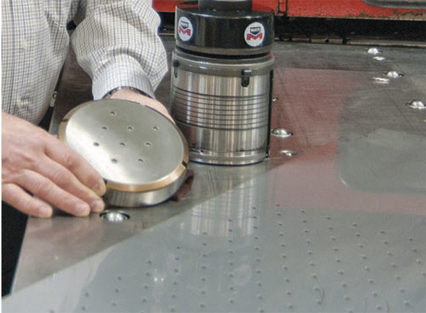

Special-application tooling plays a vital role at Dedoes, such as this nine-hole cluster punch used to punch thousands of 0.1875-in.-dia. holes in 14-gauge Type 304 stainless steel.
Special-application tooling also plays a vital role at Dedoes, “because it expands the usefulness of the firm’s turret press,” says Mate sales engineer Gary Troxell. As an example, Troxell notes filtration-system cabinets fabricated at Dedoes from 14-gauge Type 304 stainless steel. Measuring 5 by 4 by 3 ft., the cabinets incorporate multiple filtration assemblies and require the punching of thousands of 0.1875-in.-dia. holes spaced 0.45 in. apart. When punching the panels with the single-station tool supplied with the turret press, Dedoes discovered obvious limitations, particularly as order volumes grew for the punched cabinetry. Besides punching just one hole at a time with the originally supplied tool, and the frequent tool sharpening required, the tool often distorted portions of the sheet, compromising quality and resulting in scrapped parts.

Answers to these questions came quickly as Dedoes ultimately invested in a nine-hole cluster punch from Mate.

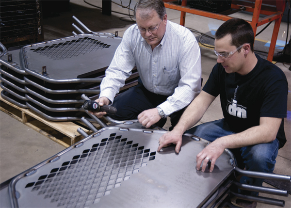

The fully guided design of the tooling system used at Dedoes pays off particularly when punched sheets have more holes than sheetmetal, by preventing the occurrence of side-loading and twisting forces. Shown are Mate sales engineer Gary Troxell (left) and Dedoes machine operator Pat Vaughn.

Tool design started with the tooling material itself. Dedoes’ cluster punch is made of M2 tool steel that resists the abrasive effects of the stainless steel by reducing heat buildup in the punches. To obtain optimal tool performance, Mate heattreats its punches in NC-controlled furnaces. This combination of high-grade tool steel and heattreating results in punches with excellent compressive strength and high wear resistance. Further, punch points are machined with a ¼-deg. back taper to reduce friction during the stripping phase of the punching cycle, further extending tool life.

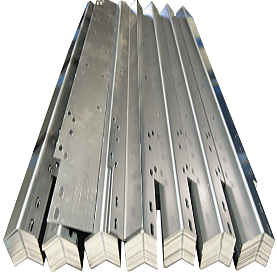

In addition to the slitting tool and cluster punch, Dedoes also uses Mate louver tools for computer cabinets; embossing tools for floor pans; and lance and form tools to enable cabinet assembly.
“All of these special-application tools allow us to reduce the number of fabricating operations without sacrificing quality,” says Vaughn. “We spend less time sharpening our tools and have experienced improved nest yields, while reducing our setup time and improving the edge quality of our punched holes.”  MF
