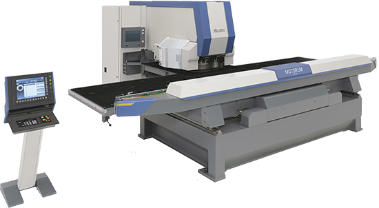

Motorum 33-ton machine
The latest turret punch presses employ features to ease setup and ensure continuing production. For example, the human-machine interface on this Motorum 33-ton machine from Muratec USA assists the operator with tooling selection, program scheduling and more.

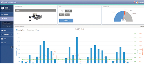

screenshot shows rocess time, standby time and alarm tie
This screenshot shows process time, standby time and alarm time on a particular machine, allowing management to develop a plan to target problem areas and improve production levels.

screen shot of process time
This screenshot of process time—when the machine is running—enables a broad view of machine capacity levels and production trends, and with multiple machines, allows better load balancing across the shop.

“Software can analyze information from the machine control, such as when it’s running, when it’s off, and when alarms occurred and why, then crunch those numbers to create useful, manageable data,” Angel says, detailing one such system, Muratec’s ProcessNet. “Management can track that and analyze trends over weeks and months, or identify the common alarms, and from that then target areas for production improvement. Or, a snapshot can indicate what machines are down and why.
