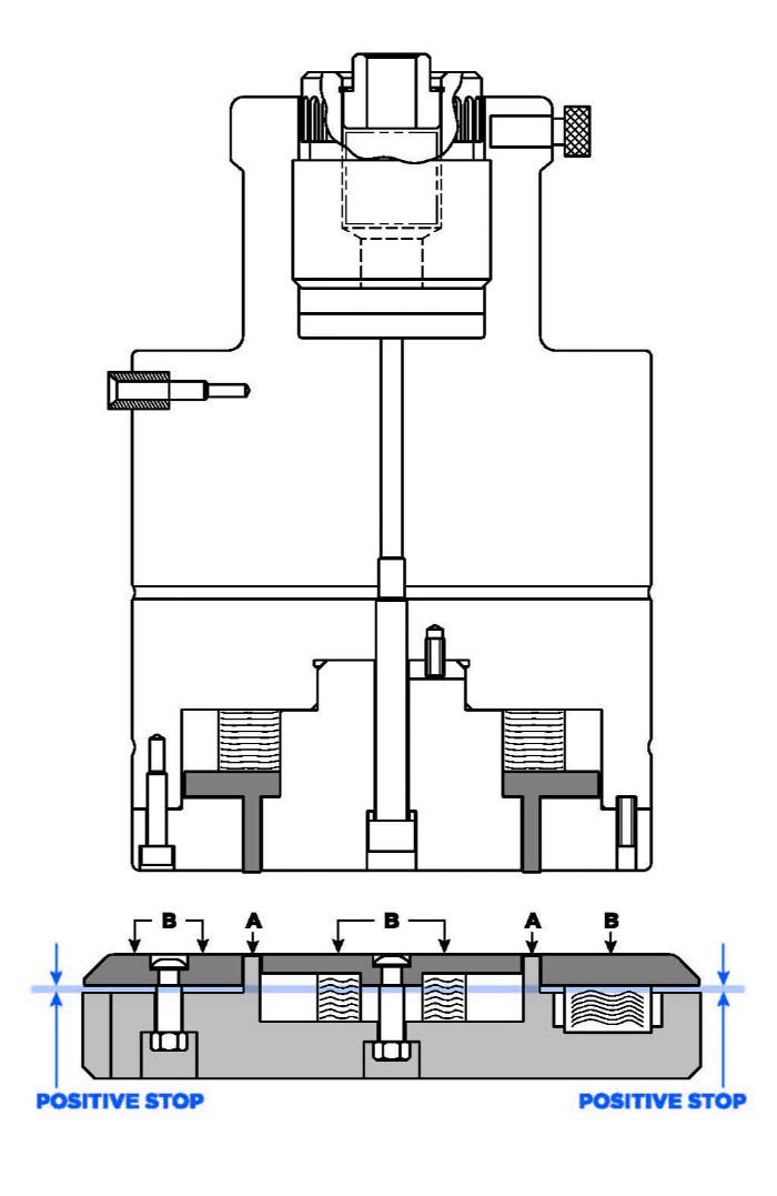

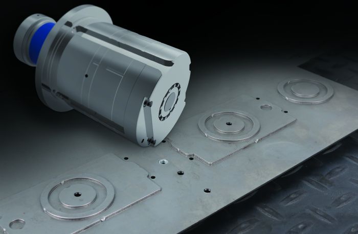

Of course, non-full-material-breakthrough applications such as forming electrical knockouts (EKOs) and other coining and embossing applications, for example, absolutely demand stopping capability built into the tooling, where material might require a raise of barely one material thickness. A small gap between the body of the tool and the tool cap, equal to the required material offset of the feature, provides for positive stop.
Positive-stop features are built into a variety of tools.
“We put positive stops in stamped-logo tools, for example, where users require a specific depth,” Erler offers. “We put it in lancing forms, again to achieve a consistent height. Once the tool bottoms out, with a properly set height adjustment, forms are consistent regardless of the pressure supplied by the machine. Most punching machines have a ±0.005 to 0.010-in. tolerance on the stroke from hit to hit, but a 0.005-in. variation on form height often is unacceptable.”
