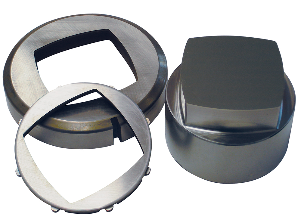

Four-Way Tool Eases Corner Rounding
Sheetmetal fabrication often produces parts with rounded edges, many times via special tools that require the use of an index station. But in many cases, a four-way radius tool can be used instead, resulting in improved process time, reduced costs and reduced machine wear.
A four-way radius tool:
  • Allows fabricators to produce corner radii with just one hit versus ribbing or use of a special tool.
  • Hits all four corners simultaneously.
  • Reduces or eliminates the need for an index station.
  • Can fit into a single station or a multitool.
  • Can be designed with micro-joint ends for shake-and-break parting applications.
For continuous-parting applications, a four-way radius tool uses one vertical hit between the parts, which helps optimize sheet nesting. The tool also can help reduce machine wear. For example, for a sheet of 100 parts, a fabricator can punch the corners with 108 hits using a four-way radius tool versus 400 hits with a special tool and an index station.
Tools Enable Additional Corner-Rounding Flexibility
Quad-radius tools can nibble large holes with smoother edges and with far fewer hits than using round nibbling punches.
For flexibility when performing corner-rounding, fabricators have options. A single nine-way corner-rounding tool provides nine external popular radii, from 1⁄2 to 1⁄16 in. Auto-index programming selects and rotates the desired radius to round off all corners of a piece-part. Fully guided tooling is recommended in such applications, as positive guiding action provides needed support when only one side of the punch is used at one time.
When specifying custom radii for corner-rounding tools, work closely with your tool supplier. For adequate corner-rounding performance, each radius should include at least 90 deg. of arc (1⁄4 of a circle). For adequate tool strength, the noses between the deep radii or groups of radii should be at least 0.188 in. wide. Any number of radii may be fitted onto the tool—limiting factors are tool size and strength.
