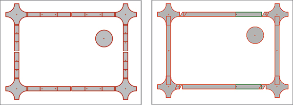

Nests made with wire joints (left) and parallelogram parting tool—the parallelogram tool (right) is a much safer option, as it allows the part to break completely from the nest with the parallelogram-shaped tab adhered to the skeleton. Often, the wire adheres to the part, endangering machine operators. |

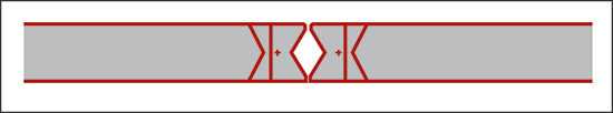

Here’s how the bow-tie tool looks on a sheet nest. |
“Not only does material utilization improve with commonline punching, but so does tool-path optimization,” Brady says. “By eliminating the ½ in. or larger gap between parts, tool travel is reduced. And, you’re reducing the number of hits per part, so tool life increases.”
“When do metal fabricators struggle with commonline punching?” I asked Brady. “The reasons relate back to my previous directive regarding sequencing,” he notes. “Lack of sheet rigidity is the most common problem fabricators experience with commonline punching. So, develop programs that make the longest parting hits at the end of the job, and als work toward the clamps.
“Also, when commonline punching small parts, say 6 by 6 in. or smaller, nested in a large sheet, create mini-nests of the parts within the sheet that leave a skeleton between the nests,” Brady suggests. “This will keep the sheet rigid and optimize part quality.”

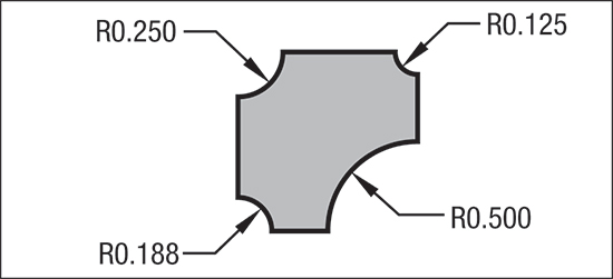

“Also, you can design a special tool to punch more than one profile,” Brady adds. “The bottom half of a tool can punch one profile and the top half a second profile—just place the tool in an auto-index station.”
As an example of where this type of tool design might shine, Brady notes corner-radiusing operations. “Rather than use separate radius tools on parts requiring varying corner radii, why not design a tool that has a different radius on each corner?” he asks rhetorically.
