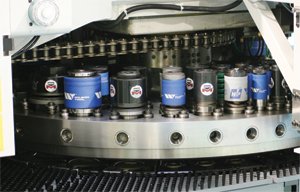

Recent punch-press innovations include quick-change tool holders, which greatly reduce setup times, and large-capacity tool turrets (shown here) with multiple, large auto-index stations, which also promote setup-time reduction and flexibility, by having more tools available when they are needed. Many users of these newer-style turrets have reduced setup times by as much as 90 percent.
