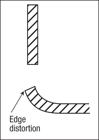

Keep slot-to-form spacing for long slots at least four times material thickness plus the bending radius (4t + R) to prevent the slot edge from distorting (Fig. 2). If additional holes also are required, punch the holes first, form the flange, and then punch the slot.
When large and small holes are located close to each other, punch the larger hole first. This prevents distortion of the smaller hole caused by the cutting action of the larger punch.

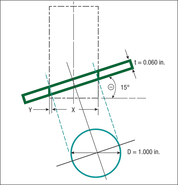

Some irregular-shape stamping geometries may require tipping of the part in the die, because there is a limit when it comes to punching on an angle. A common practice has been to limit cutting and punching angles to a maximum of 15 deg., to avoid the complex guiding and support systems needed to control punch, stripper and part deflection. When punching angle exceeds 15 deg., it generally is less costly and more reliable to add an additional operation or use a cam.
Stampers also may struggle with hole-size accuracy when performing angular punching. The punch cuts a hole opening in the part that on a slight angle, but the part print requires the hole size to be measured perpendicular to the part surface. As a result, the shape and size of the punch will be different than the final hole diameter (Fig. 3).
