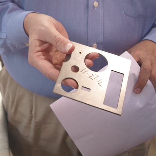

When we visited the firm, Laystrom’s brother Jim was busy developing a new process-validation methodology to help the firm minimize its cost of quality. “We’re piloting a process to shift from product validation to process validation,” says engineering manager Jim Laystrom. “To get started, we’re creating standard coupons of varying combinations of workpiece material types and thicknesses, and laser-cutting the coupons to develop acceptable cut quality, then documenting the process 4 third-, and fourth-run parts orders that have gone through the laser one time will not require first-part inspection from our quality-control department. Instead, the machine operator will simply compare the part to the coupon, verify proper process settings —optics, cutting parameters and so on —and he’ll be good to go. This will dramatically decrease our quality costs and increase machine run time.”

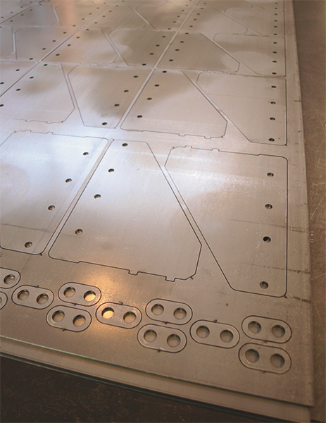

Also impacting quality has been the firm’s dedication to maintaining the integrity of the cutting bed, an egg-crate-style bed comprised of V-cut slats of sheetmetal. “As the slats wear from use, the workpiece material may move out of level, which can impact cut-edge quality,” says manufacturing engineer Terry Foley. “So we ask our operators to keep a close eye on the condition of the cutting-machine beds and change out the slats—which we cut ourselves—regularly. This is particularly important when working with thinner work. And, when jobs run lights-out, any quality issues caused by out-of-level work will compound sheet after sheet. We certainly don’t want a quality issue to persist through an entire untended shift.”
Lastly, cut-edge quality took a turn for the better when, in 2008, the firm committed to using nitrogen assist gas, rather than oxygen, on any work thicker than 11 gauge. “Nitrogen cuts faster and improves edge quality to help avoid deburring and improve paint adhesion,” says laser technician Hugo Vega. “We’ve been taking on more stainless-steel work and heavier-gauge mild steel,” adds manufacturing manager Eric Hauser.

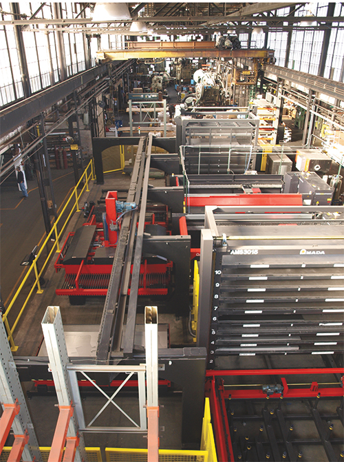

Watching the automated laser-production cell run is like watching a carefully directed symphony. Each cell component relies on the other components, and the entire orchestra of parts relies on the conductor—the operator (and also the programmer) to carefully direct its activities. Featured is the Amada AMS 3015 system; Amada says that more than half of its customers that have purchased the system have added a second laser, as has Laystrom. The modular building-block system includes the raw-material and finished-sheet storage towers, and shuttle tables for carrying material to and from each laser-cutting machine. Each tower shelf is rated to 4400 lb. of material and a maximum stacking height of just under 5 in. “And, down the road we can increase capacity by adding another five shelves to the material tower,” says Bob Laystrom.
The goal when programming the cell, explains second-shift supervisor Sergio Cano, is to try to have one cutting machine running jobs with longer cycle times, and load shorter-running jobs on the second cutting machine, to “minimally disrupt the material-handling automation,” says Cano. “But then we may have days where one laser runs from the automation all day while the operator loads smaller blanks on the second machine, to process small orders.”
Most often, the workcell processes a fully loaded tower of raw material over two shifts. The operator will start his day by spending 2 hr. loading the material-storage shelves to capacity, and initiating the programmed run cycle from the cell scheduling controller. “We probably run 50 different types and thicknesses of carbon steel, stainless steel and aluminum regularly,” adds Vega.
The software (Amada’s Dr. Abe) then takes over. It tracks inbound material inventory, and also keeps tabs on where each job ends up in the finished-goods tower. “And we can monitor the entire cell over the Internet via computer or smart phone,” adds Foley.
