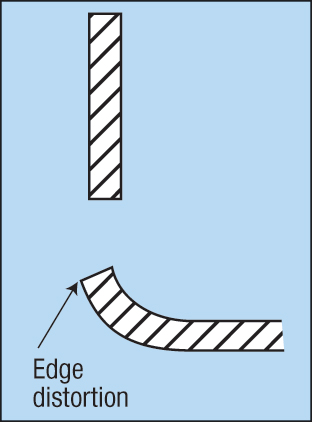

Cutting and punching are the most common operations performed by stamping dies. The die-process engineer must carefully consider the punching and cutting sequence in order to maintain product quality and process stability. For example, when the location of a hole in a sidewall or a vertical flange is critical, the process engineer may choose to punch the hole after all of the forming has been completed. Although it would be far less expensive to punch the hole in the flat before forming, maintaining an accurate position in the stamping may prove to be very difficult with this approach.

Edge Distortion
 Fig. 2

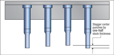

Stagger Punches
 Fig. 3
• Simultaneously punch holes in flanges after drawing and forming. This eliminates the need to locate off previously punched holes in subsequent operations. Maintaining tight tolerances becomes increasingly more difficult with multiple punching operations.• When piercing a pattern of multiple holes, stagger the punches so that the inner most holes are punched last (Fig. 3). This significantly reduces the amount of stripping force required to extract the punches.
