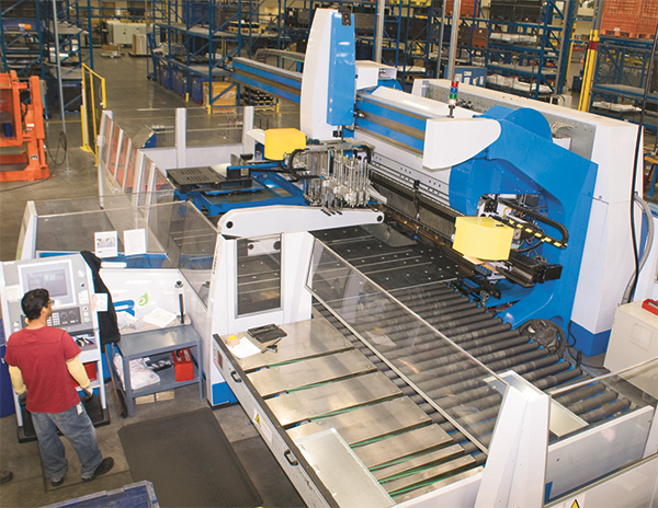

Sub-Zero’s servo-electric panel bender has a maximum bending length of 100 in. and a maximum opening height of 8 in. Using the bender, production is completely automated, from the loading of flat, punched parts to the unloading of the finished product.
Following the 2008 addition of its punch-shear combo, in 2009 Sub-Zero acquired a servo-electric panel bender (the Prima Power EBe Express Bender). Using the bender, production is completely automated, from the loading of flat, punched parts to the unloading of the finished product.
The machine has a maximum bending length of 100 in. and a maximum opening height of 8 in. Actuation of the bending blade (vertical and horizontal) is by NC servo motors, instead of hydraulic cylinders. Upper-tool movement also is driven by an NC servo motor.

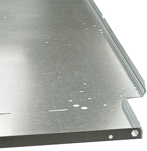

“The EBe has been a very dependable machine,” says Dolinski. “It just runs and runs. One of our jobs used to require three separate press-brake operations to produce 80 to 100 parts in an 8-hr. shift. With the EBe, we complete the job in just 90 min.”
Describing additional benefits of the panel bender, Dolinski explains that while the EBe is used primarily on galvanized parts, it will soon begin to form stainless-steel panels. “On these large stainless panels, we often require two different press-brake operations,” says Dolinski. “With the tool change in between operations, it takes an operator as long as 4 hr. to run the parts. We can fabricate the same part in about 1 min. on the panel bender, and setup time is next to nothing. And we also can emboss the panels on the bend line.”
