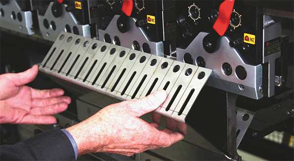

Fig. 3—Chain-tabbed sheets can allow a metalformer to gang-bend all of the parts simultaneously in a press brake, which can be a huge time saver when bending large quantities of small parts.

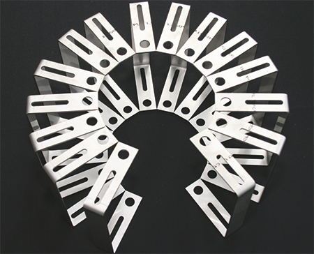

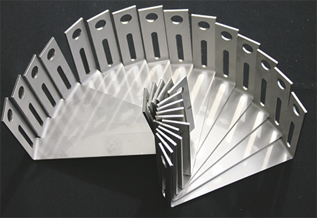

 Figs. 4-5—After gang-bending small parts that have been chain-cut, an operator simply separates the individual tabbed parts from the blank.

Last but not least, chain-tabbed sheets can allow a metalformer to gang-bend all of the parts simultaneously in a press brake (Fig. 3). Obviously this can be a huge time saver when bending large quantities of small parts requiring one or two bends. After bending, the operator simply separates the individual tabbed parts from the blank (Figs. 4-5).
In the example shown, rather than making 30 bends in the press brake to form the 15 parts, only two strokes of the press-brake ram are required. MF
