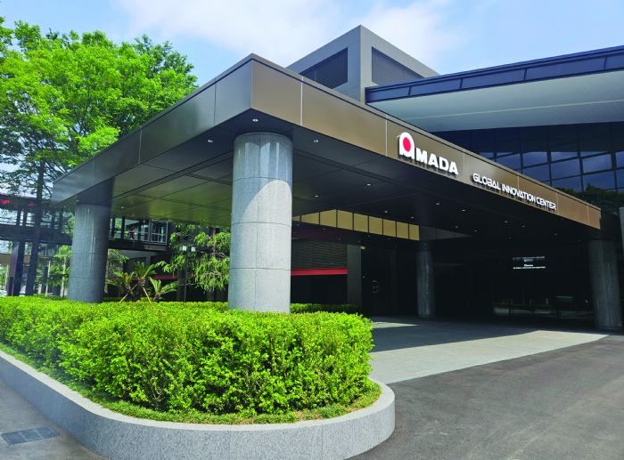

Amada’s Yamamoto mirrored this philosophy as he explained to those gathered the commitment Amada has made to sound ESG (environmental, social and governance) management, including the use of artificial intelligence to address environmental concerns within the manufacturing process. We saw evidence of these practices when touring the beautiful, technology-infused AGIC facility. For example, the facility employs energy-saving products and software that can monitor and control the environmental load throughout its entirety.
Additionally, the building of the AGIC “represents the latest environmentally friendly equipment,” company officials stressed, “with CO2 emissions reduced to half those of conventional facilities.”

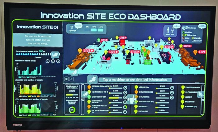

On the ESG front, our tour highlighted several environmentally friendly features built into the facility. Officials explained how this technology works in one of two areas of the facility it refers to as Innovation Sites. Innovation Site 1 is home to an ECO Dashboard, displaying AI-based detection of people’s whereabouts within the facility. It then uses this data to optimize HVAC and lighting, to conserve energy.

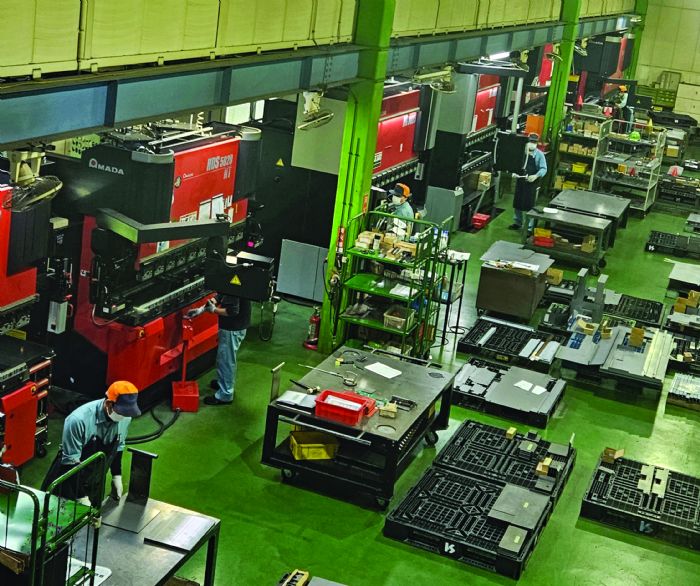

Many of the blanks produced in the FMS cell feed 16 Amada press brakes along the company’s bend processing line, with two featuring Amada’s ATC (automatic tool changing) technology, including Kanto Seiko’s newest brake, an EGB 6020e—introduced to North America during FABTECH 2022. This press brake’s HMI combines with the ATC to enable tool changes within 50 sec. And, the HMI enables operators to check correct workpiece positioning via a reference tablet mounted on the crown of the machine above the work area.
