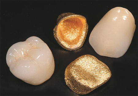

The Argen SLMCaptek crown is printed on a Concept Laser Mlab machine, and then infiltrated with gold and veneered with porcelain. |

Argen also worked with Concept Laser to develop a unique sintering process to manufacture its proprietary Captek crowns. Printed on the Mlab machines, these unique crowns combine a 3D-printed layer of a platinum-palladium-gold alloy that’s sintered to 50-percent dense, which then is infiltrated with gold and veneered with porcelain.
“The process creates a strong core with an attractive outer surface,” Cascone says. “The traditional manual fabrication of these crowns was very labor intensive and reliant on the skills of our technicians. Now we build the initial layers on the Mlab with a significant increase in productivity and throughput.”
