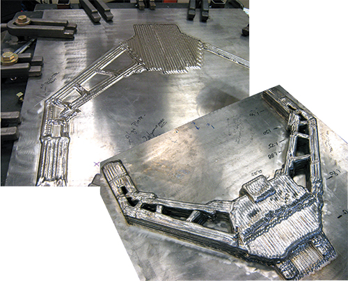

Figs. 1 and 2—A double-sided directed energy deposition structure with integrated build platform—building on both sides of the plate balances residual stresses and helps to achieve higher productivity.
DED, one of two metal AM process categories defined by ASTM International (the other: powder bed fusion), builds shapes bead by bead, layer by layer, using either computer numerical controlled (CNC) or robotic systems with wire, powder or strip consumables. A wide range of DED processes use welding process equipment, including gas metal arc, plasma arc, gas tungsten arc, laser, electron-beam, and ultrasonic welding. Robotic-arc DED offers maximum build volume and range of motion for depositing shapes and features.
From a qualification perspective, DED AM builds are single-sided, non-integrated build platform (SS-NIBP); single-sided, integrated build platform (SS-IBP); and double-sided, integrated build platform (DS-IBP). All of these categories support adding features and building shapes with a cost-effective mix of welding structural forms (plate, pipe, castings, forgings, etc.) and AM. Figs. 1 and 2 show a double-sided DED structure with integrated build platform that can produce beams and other structures. Building on both sides of the plate balances the residual stresses and helps to achieve higher productivity.
