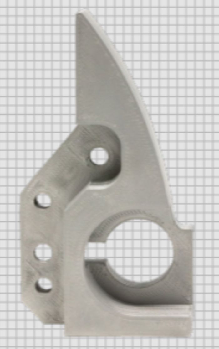

Desktop-Metal-Assembly-Line-Screwdriver-ToolThis enables significant lightweighting of parts, in some cases by as much as 30 percent, resulting in less wear-and-tear on machinery and less downtime on the manufacturing floor. In addition, the technology has opened the door to designing improved workflows, particularly related to machining, which, otherwise, may be too time- and labor-intensive to pursue. A main target for those improvements: post-processing of parts in CNC machines.

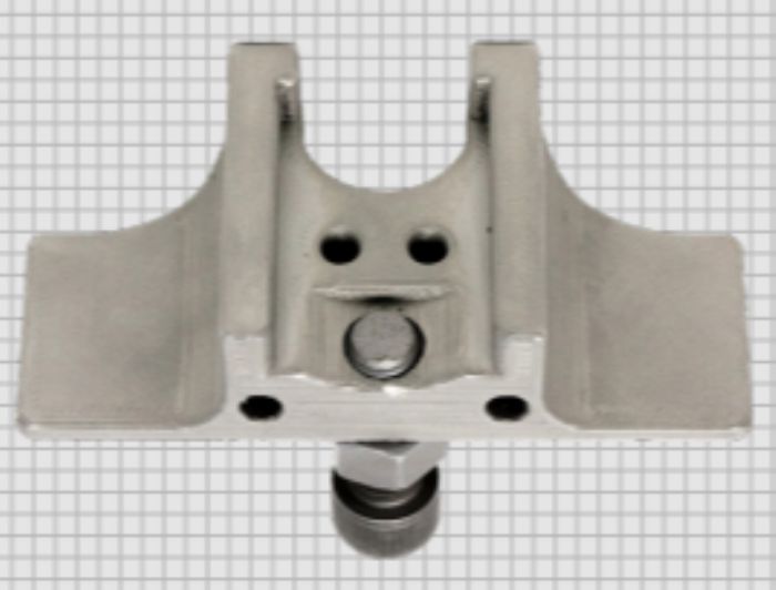

Desktop-Metal-Alpha-Coining-FixtureWhen exploring the use of metal 3D printing, APG tested parts printed on the Studio System for their dimensional tolerances and metallurgical properties. Overall, APG engineers found that printed parts had tolerances comparable to traditionally manufactured parts. To evaluate material properties, APG engineers printed a number of sample parts, then halved them for examination of metal density and grain structure. Tests revealed that the printed metals showed hardness levels, density and grain structure in line with parts created via MIM.

For example, rather than requiring staff to manually tighten and loosen part fixtures, engineers designed a custom-made ratchet screwdriver tool to automate the process. Using the Studio System, they printed the tool, with its complex ratchet assembly, in only a few days from 17-4 PH stainless steel. APG officials note 93-percent cost savings and 87-percent time savings as compared to traditional manufacturing. The tool allows a single operator to run as many as five CNC machines at a time, producing a more efficient workflow and significant labor-cost savings.
Also produced through APG’s 3D printing capability, coining fixtures, which require custom geometry for each application and superior wear resistance to withstand repeated use cycles. Using the Studio System, APG printed an inhouse-designed coining fixture from 17-4 stainless steel and begin employing it in only three days. Overall, the new 3D-printed fixture offered 76-percent cost savings and 84-percent time savings as compared to traditional manufacturing.
