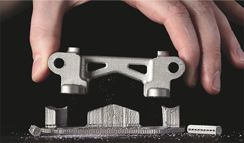

Proprietary Separable Supports make it possible to remove support structures by hand (see photo), while swappable print cartridges make for safe, rapid material changes. And, it reportedly can support hundreds of different metal alloys.
