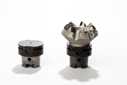

A machined tool holder (left), and with the metal-AM cutting head attached (right), shows how a hybrid process using referencing software can produce components.

This method of subtractive-first hybrid manufacturing employing the referencing software has many obvious benefits for producing mold-and-die inserts and machined tool holders with AM tool heads, for example, but also proves useful for part production in such industries as medical and aerospace. Shops can cut preforms prior to building complex part features via 3D metal printing. Applications include aerospace components and medical devices that feature complex internal structures, as well as the creation of functional surfaces for products such as implants, which benefit from geometric precision inherent in AM for building metal forms that promote improved integration with existing skeletal and vascular structures.
