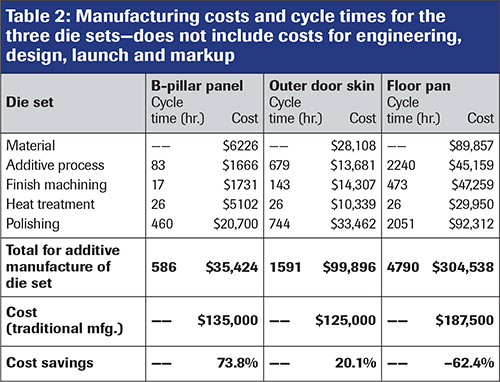

Ricardo and UTRC estimated the cost savings realized by 3D printing dies for three Toyota Corolla parts (Table 1): a B-pillar panel, door outer skin and main floor pan. Manufacturing the parts requires die sets for blanking, drawing and a trim/pierce operation; the cost comparison focused on the draw die set for each component.
The B-pillar panel is the smallest part, and has the smallest draw depth. The floor pan is the largest part, in crosssection and in draw depth. Table 2 presents the costs and the time required to produce the die sets via WAAM, including finish machining, polishing and heattreatment.
The results of this economic assessment show that the cost benefit of 3D printing the draw die depends on the part size and depth of draw. The draw die for the B-pillar panel requires less material deposition due to the smaller part size and relatively shallow draw depth, so it’s less expensive to manufacture. However, as draw depth increases the cost savings achieved by using additive manufacturing diminish, due to the relatively slow deposition rate from the WAAM process.
The substantial difference in additive-process cycle time to 3D-print the die sets for the B-pillar and floor pan (Table 2) reflects the difference in the amount of material deposition required. Further, since the cost of the weld wire exceeds that of the base metal, material cost becomes significant as draw depth and part size increases. A common trend in cost estimates for the three die sets is that finish machining and polishing account for the majority of the manufacturing cost. Therefore, tooling can be made less expensively with 3D printing when parts do not require a high surface finish.
