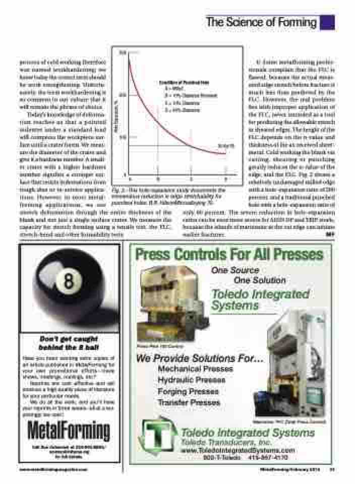

4) Some metalforming profes- sionals complain that the FLC is flawed, because the actual meas- ured edge stretch before fracture is much less than predicted by the FLC. However, the real problem lies with improper application of the FLC, never intended as a tool for predicting the allowable stretch in sheared edges. The height of the FLC depends on the n-value and thickness of the as-received sheet- metal. Cold working the blank via cutting, shearing or punching greatly reduces the n-value of the edge, and the FLC. Fig. 2 shows a relatively undamaged milled edge with a hole-expansion ratio of 280 percent, and a traditional punched hole with a hole-expansion ratio of
only 80 percent. The severe reduction in hole-expansion ratios can be even more severe for AHSS DP and TRIP steels, because the islands of martensite at the cut edge can initiate
Fig. 2—This hole-expansion study documents the tremendous reduction in edge stretchability for punched holes. R.R. HilsonMicroalloying 75.
earlier fractures.

  300
200
100
Condition of Punched Hole
A = Milled
B = 10% Clearance Removed C = 10% Clearance
D = 40% Clearance
30 Ksi YS
ABCD

Hole Expansion, %
