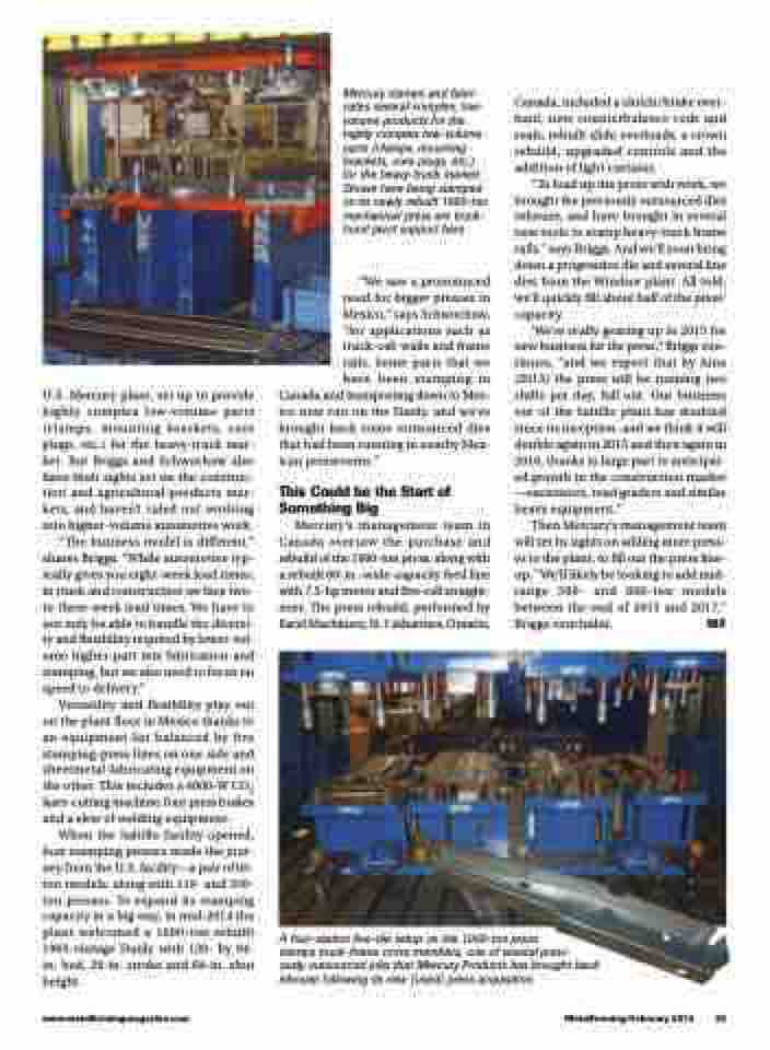

When the Saltillo facility opened, four stamping presses made the jour- ney from the U.S. facility—a pair of 65- ton models, along with 110- and 350- ton presses. To expand its stamping capacity in a big way, in mid-2014 the plant welcomed a 1000-ton rebuilt 1963-vintage Danly with 120- by 84- in. bed, 20-in. stroke and 64-in. shut height.
Mercury stamps and fabri- cates several complex, low- volume products for the highly complex low-volume parts (clamps, mounting brackets, core plugs, etc.) for the heavy-truck market. Shown here being stamped on its newly rebuilt 1000-ton mechanical press are truck- hood pivot support bars.

Mercury’s management team in Canada oversaw the purchase and rebuild of the 1000-ton press, along with a rebuilt 60-in.-wide-capacity feed line with 7.5-hp motor and five-roll straight- ener. The press rebuild, performed by Excel Machinery, St. Catharines, Ontario,
Canada, included a clutch/brake over- haul, new counterbalance rods and seals, rebuilt slide overloads, a crown rebuild, upgraded controls and the addition of light curtains.

A four-station line-die setup on the 1000-ton press
stamps truck-frame cross members, one of several previ- ously outsourced jobs that Mercury Products has brought back inhouse following its new (used) press acquisition.
