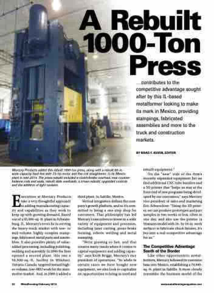

 Mercury Products added this rebuilt 1000-ton press, along with a rebuilt 60-in.- wide-capacity feed line with 7.5-hp motor and five-roll straightener, to its Mexico plant in mid-2014. The press rebuild included a clutch/brake overhaul, new counter- balance rods and seals, rebuilt slide overloads, a crown rebuild, upgraded controls and the addition of light curtains.
