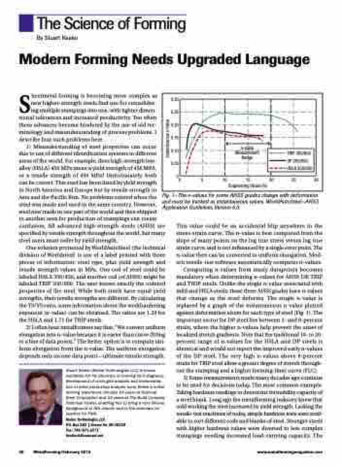

  0.30 0.25 0.20 0.15 0.10 0.05
0 5 10 15 20 25 30 Engineering Strain (%)
             n-va Measur
lue ement
   Range
TRIP 350/600 DP 350/600 HSLA 350/450

Fig. 1—The n-values for some AHSS grades change with deformation and must be tracked as instantaneous values. WorldAutoSteel—AHSS Application Guidelines Version 5.0.
This value could be an accidental blip anywhere in the stress-strain curve. The n-value is best computed from the slope of many points on the log true stress versus log true strain curve, and is not influenced by a single error point. The n-value then can be converted to uniform elongation. Mod- ern tensile-test software automatically computes n-values.
Computing n-values from many datapoints becomes mandatory when determining n-values for AHSS DP, TRIP and TWIP steels. Unlike the single n-value associated with mild and HSLA steels, these three AHSS grades have n-values that change as the steel deforms. The single n-value is replaced by a graph of the instantaneous n-value plotted against deformation strain for each type of steel (Fig. 1). The important sector for DP steel lies between 3- and 8-percent strain, where the higher n-values help prevent the onset of localized stretch gradients. Note that the traditional 10- to 20- percent range of n-values for the HSLA and DP steels is identical and would not report the improved early n-values of the DP steel. The very high n-values above 8-percent strain for TRIP steel allow a greater degree of stretch through- out the stamping and a higher forming-limit curve (FLC).
