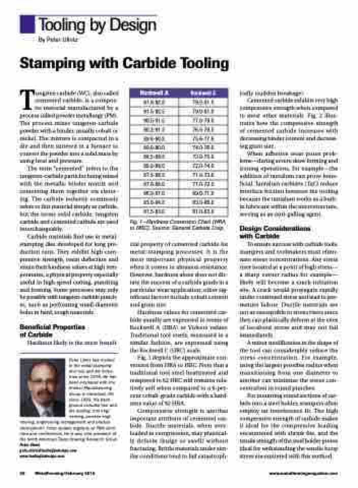

Stamping with Carbide Tooling
  Rockwell A
Rockwell C
91.8-92.8
79.5-81.5
91.5-92.5
79.0-81.0
90.5-91.5
77.0-79.0
90.2-91.2
76.5-79.5
89.8-90.8
75.6-77.6
89.0-90.0
74.0-76.0
88.5-89.5
73.0-75.0
88.0-89.0
72.0-74.0
87.5-88.5
71.0-73.0
87.0-88.0
71.0-72.0
86.0-87.0
69.0-71.0
83.0-84.5
63.0-66.0
81.5-83.0
61.0-63.0

Fig. 1—Hardness Conversion Chart (HRA to HRC). Source: General Carbide Corp.
cial property of cemented carbide for metal-stamping processes. It is the most important physical property when it comes to abrasion resistance. However, hardness alone does not dic- tate the success of a carbide grade in a particular wear application; other sig- nificant factors include cobalt content and grain size.
Hardness values for cemented car- bide usually are expressed in terms of Rockwell A (HRA) or Vickers values. Traditional tool steels, measured in a similar fashion, are expressed using the Rockwell C (HRC) scale.
Fig. 1 depicts the approximate con- version from HRA to HRC. Note that a traditional tool steel heattreated and tempered to 62 HRC still remains rela- tively soft when compared to a 6-per- cent cobalt-grade carbide with a hard- ness value of 92 HRA.
