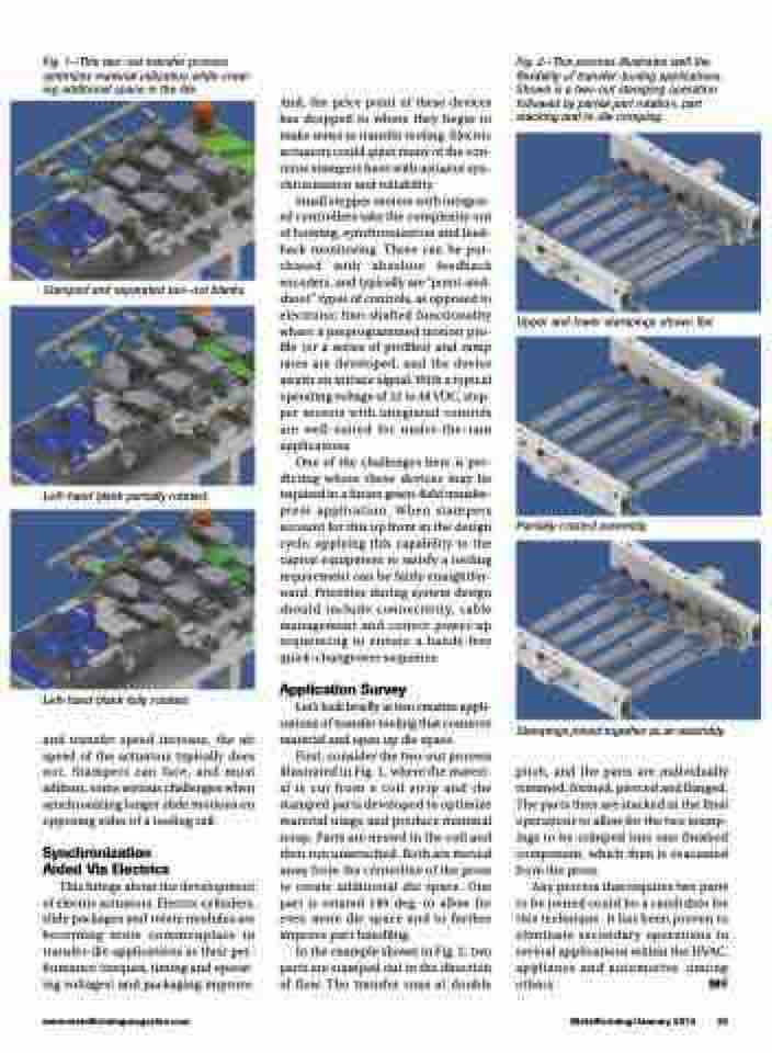

Fig. 2—This process illustrates well the flexibility of transfer-tooling applications. Shown is a two-out stamping operation followed by partial part rotation, part stacking and in-die crimping.
  Upper and lower stampings shown flat.
  Partially rotated assembly.
  Fig. 1—This two-out transfer process optimizes material utilization while creat- ing additional space in the die.
  Stamped and separated two-out blanks.
  Left-hand blank partially rotated.
  Left-hand blank fully rotated.

Let’s look briefly at two creative appli- cations of transfer tooling that conserve material and open up die space.
First, consider the two-out process illustrated in Fig. 1, where the materi- al is cut from a coil strip and the stamped parts developed to optimize material usage and produce minimal scrap. Parts are nested in the coil and then run unattached. Both are moved away from the centerline of the press to create additional die space. One part is rotated 180 deg. to allow for even more die space and to further improve part handling.
In the example shown in Fig. 2, two parts are stamped out in the direction of flow. The transfer runs at double
Stampings joined together as an assembly.
pitch, and the parts are individually trimmed, formed, pierced and flanged. The parts then are stacked in the final operations to allow for the two stamp- ings to be crimped into one finished component, which then is evacuated from the press.
Any process that requires two parts to be joined could be a candidate for this technique. It has been proven to eliminate secondary operations in several applications within the HVAC, appliance and automotive, among others. MF
