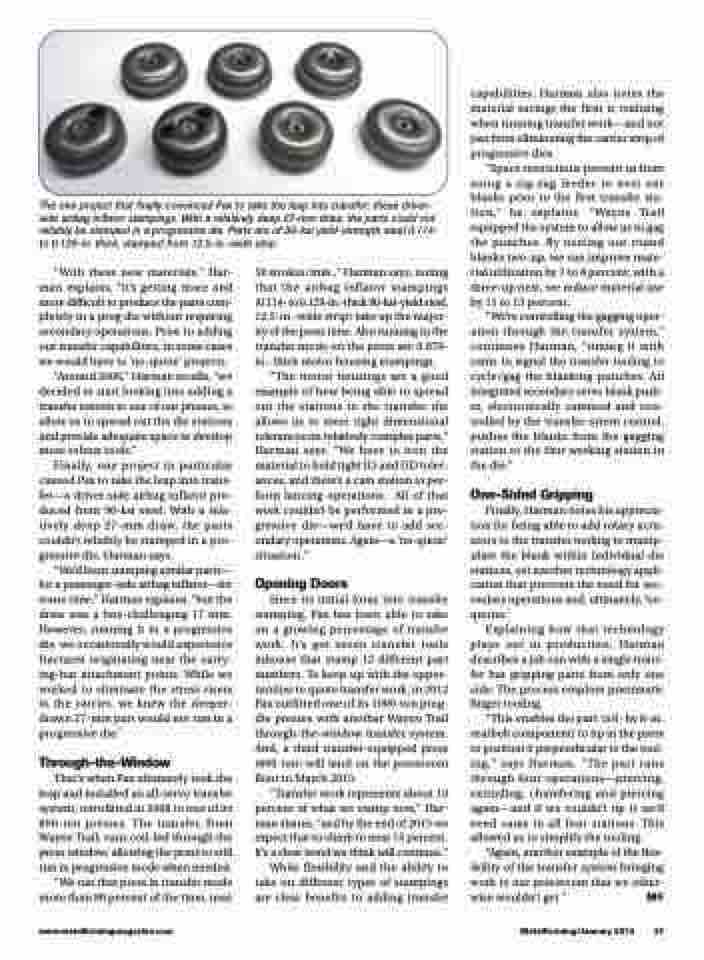

 The one project that finally convinced Pax to take the leap into transfer: these driver- side airbag inflator stampings. With a relatively deep 27-mm draw, the parts could not reliably be stamped in a progressive die. Parts are of 90-ksi yield-strength steel 0.114- to 0.129-in. thick, stamped from 12.5-in.-wide strip.

Finally, one project in particular caused Pax to take the leap into trans- fer—a driver-side airbag inflator pro- duced from 90-ksi steel. With a rela- tively deep 27-mm draw, the parts couldn’t reliably be stamped in a pro- gressive die, Harman says.
“We’d been stamping similar parts— for a passenger-side airbag inflator—for some time,” Harman explains, “but the draw was a less-challenging 17 mm. However, running it in a progressive die, we occasionally would experience fractures originating near the carry- ing-bar attachment points. While we worked to eliminate the stress risers in the carrier, we knew the deeper- drawn 27-mm part would not run in a progressive die.”
