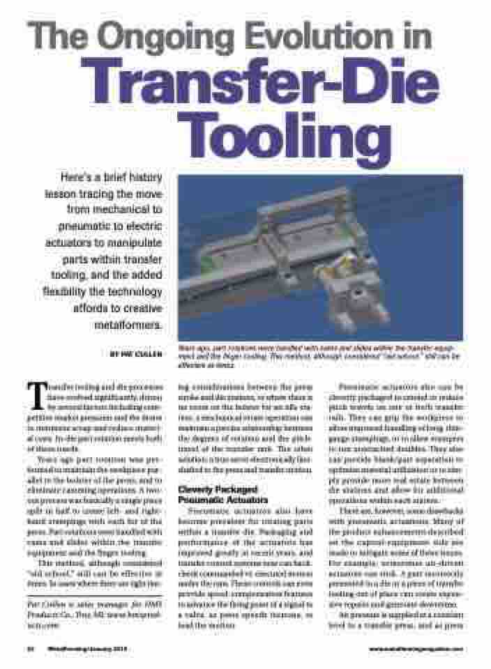

Years ago part rotation was per- formed to maintain the workpiece par- allel to the bolster of the press, and to eliminate camming operations. A two- out process was basically a single piece split in half to create left- and right- hand stampings with each hit of the press. Part rotations were handled with cams and slides within the transfer equipment and the finger tooling.
This method, although considered “old school,” still can be effective at times. In cases where there are tight tim-
Pat Cullen is sales manager for HMS Products Co., Troy, MI; www.hmsprod- ucts.com.
Years ago, part rotations were handled with cams and slides within the transfer equip- ment and the finger tooling. This method, although considered “old school,” still can be effective at times.
 ing considerations between the press stroke and die stations, or where there is no room on the bolster for an idle sta- tion, a mechanical rotate operation can maintain a precise relationship between the degrees of rotation and the pitch- travel of the transfer unit. The other solution: a true servo electronically line- shafted to the press and transfer motion.
