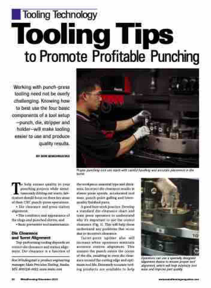

Proper punching-tool use starts with careful handling and accurate placement in the turret.

Turret-press uptime also will increase when operators maintain accurate station alignment. This ensures the punch enters the center of the die, resulting in even die clear- ance around the cutting edge and opti- mum tool life. Extremely accurate tool- ing products are available to help
Operators can use a specially designed alignment device to ensure proper tool alignment, which will help minimize tool wear and improve part quality.
