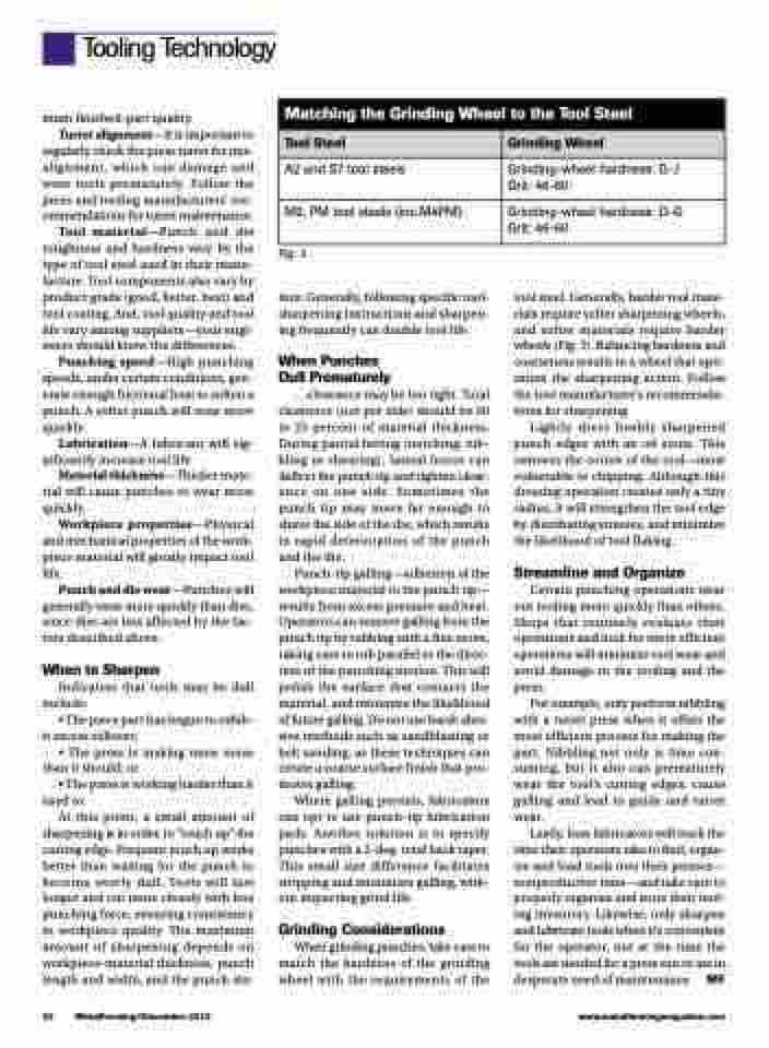

  Tooling Technology
    Matching the Grinding Wheel to the Tool Steel
 Tool Steel
Grinding Wheel
A2 and S7 tool steels
Grinding-wheel hardness: G-J Grit: 46-60
M2, PM tool steels (inc.M4PM)
Grinding-wheel hardness: D-G Grit: 46-60

Fig. 3

Grinding Considerations
When grinding punches, take care to match the hardness of the grinding wheel with the requirements of the
tool steel. Generally, harder tool mate- rials require softer sharpening wheels, and softer materials require harder wheels (Fig. 3). Balancing hardness and coarseness results in a wheel that opti- mizes the sharpening action. Follow the tool manufacturer’s recommenda- tions for sharpening.
Lightly dress freshly sharpened punch edges with an oil stone. This removes the corner of the tool—most vulnerable to chipping. Although this dressing operation creates only a tiny radius, it will strengthen the tool edge by distributing stresses, and minimize the likelihood of tool flaking.
