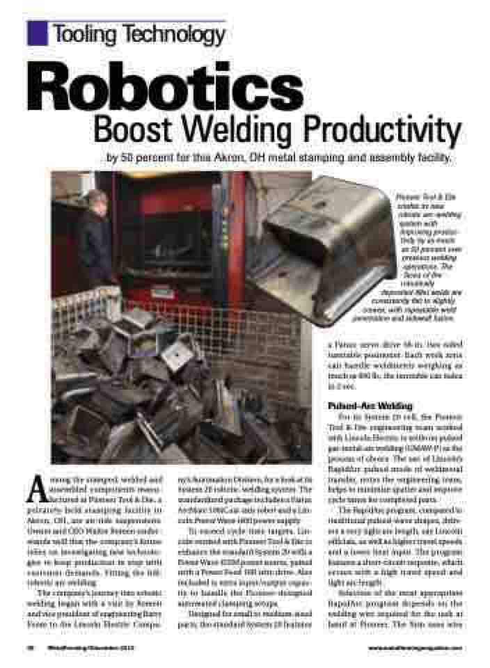

Pioneer Tool & Die credits its new
robotic arc-welding system with improving produc-
tivity by as much as 50 percent over previous welding
operations. The
faces of the robotically
deposited fillet welds are consistently flat to slightly convex, with repeatable weld penetration and sidewall fusion.
