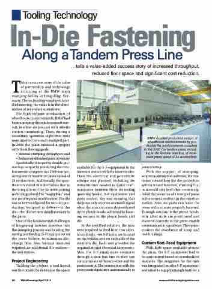

  BMW doubled production output of
wheelhouse reinforcements by pro- ducing the reinforcements complete in this 2500-ton tandem press, includ- ing in-die fastener insertion, at maxi- mum press speed of 25 strokes/min.
