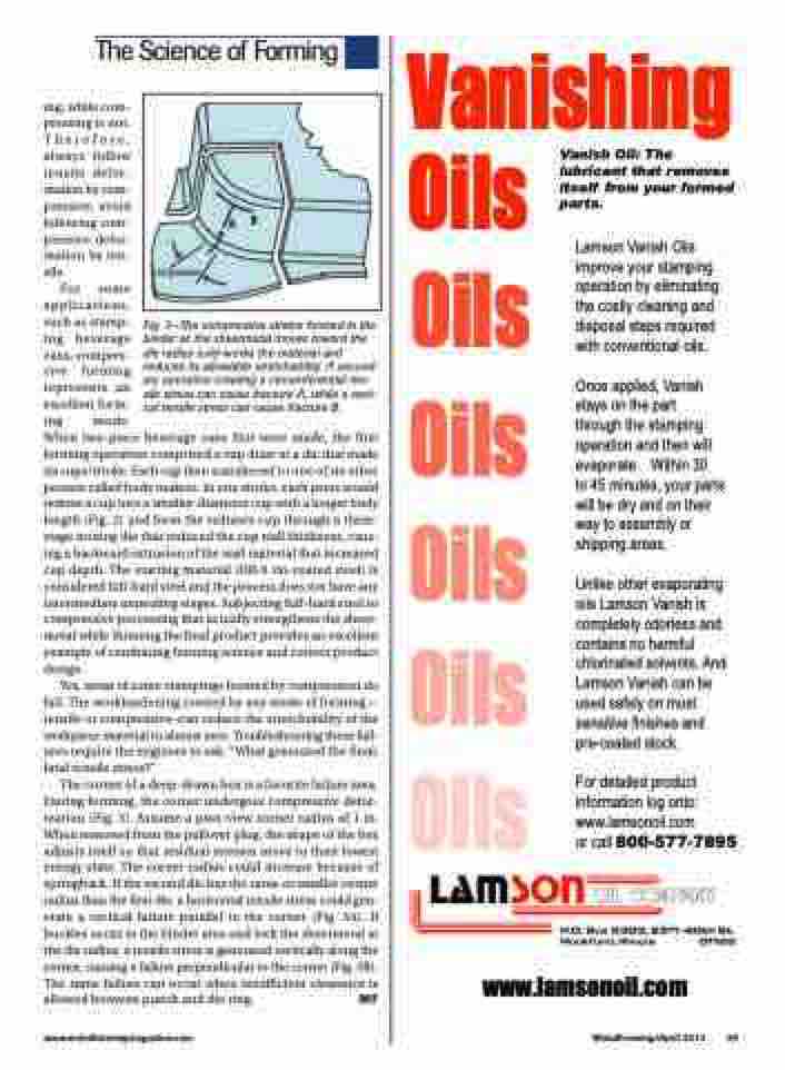

Fig. 3—The compressive strains formed in the binder as the sheetmetal moves toward the die radius cold-works the material and reduces its allowable stretchability. A second- ary operation creating a circumferential ten- sile stress can cause fracture A, while a verti-

The corner of a deep-drawn box is a favorite failure area. During forming, the corner undergoes compressive defor- mation (Fig. 3). Assume a plan-view corner radius of 1 in. When removed from the pullover plug, the shape of the box adjusts itself so that residual stresses move to their lowest energy state. The corner radius could increase because of springback. If the second die has the same or smaller corner radius than the first die, a horizontal tensile stress could gen- erate a vertical failure parallel to the corner (Fig. 3A). If buckles occur in the binder area and lock the sheetmetal at the die radius, a tensile stress is generated vertically along the corner, causing a failure perpendicular to the corner (Fig. 3B). The same failure can occur when insufficient clearance is allowed between punch and die ring. MF
