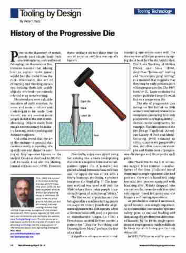

                              Upper die Blank Lower die
Anvil
    Eventually, coins were struck using two coining dies: a lower die depicting the coin in a negative form and a com- panion upper die. A metalworker placed a blank between these two dies and the upper die was struck with a heavy hammer, rendering a positive image on the blank (Fig. 1). The ham- mer method was used well into the Middle Ages. Even today people occa- sionally speak of coins being “struck.”
