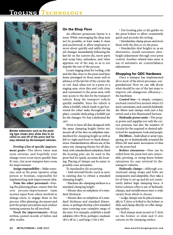

Bolster extensions—Dies can be rolled from the press bed onto remov- able, pivoting, or swing-down bolster extensions for easy retrieval by die- transport vehicles.

   Bolster extensions such as the pivot- ing type shown here allow dies to be rolled on and off of the press bed for easy retrieval by die-transport vehicles.
