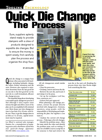

A good first step to quickening the pace of die changes: create an efficient press- room layout, and store dies close and convenient to the press area, with easy access to the dies by the transport vehicle. Photo courtesy of Green Valley Mfg.
