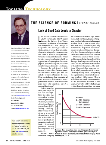

has some form of sheared edge. Exam- ples include cut blanks, trimmed stamp- ings, punched holes, cutouts, lances and notches. Look at your sheared edge. Nice and clean, no rollover, few very minor burrs, 40-percent burnish/60- percent break, very little shear damage. Why does that sheared edge tear at low strain levels when subjected to tension?
While one assumes that a normal- looking sheared edge has suffered little damage, data has proven differently. A classic test was performed by Bob Hilsen of Inland Steel (See graph). The tradi- tional 10-percent shear clearance pro- duced a hole expansion of 80 percent. Cleaning off any burrs and squaring the edge increased available hole expan- sion to about 140 percent. When a milled hole was tested, a hole expansion of 280 percent was achieved. If one assumes very little cold worked damage to the sheared edge, then any edge

Damage done by various hole-punching operations tested by the traditional hole expansion test. (Research by R.R. Hilson of Inland Steel and presented at Microalloying 75 in Washington, D.C.)
   300
200
100
A = Milled
B = 10% Clearance burr removed
C = 10% Clearance D = 40% Clearance
    30 Ksi YS
AB C D

Hole Expansion, %
