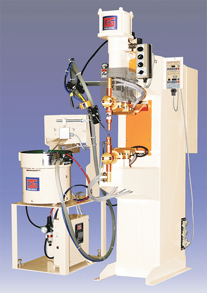

single-point projection-welding system combining a pedesal welder and nut/bolt feeder
To achieve a successfully projection-welded part, the welding machine must be correctly sized for the particular fastener being welded. The frame of the machine and the electrode assembly must be rigid to avoid flexure and misalignment under load. Shown: a single-point projection-welding system combining a pedestal welder and nut/bolt feeder.

First, ensure that the welding machine is correctly sized for the particular fastener being welded, and that the required welding conditions fall within the normal operating range of the machine. The frame of the welding machine and the electrode assembly must be rigid to avoid flexure and misalignment under load. The electrode force must be able to hold each projection firmly against the stamping during the initial period of the weld time, and must have good follow-up characteristics when the projections collapse during the welding process. Slow follow-up will result in metal expulsion before the parts come together.
Also ensure that the surfaces of the electrodes are flat and well-aligned. They must have clean contact points and be free from oil, dirt or film. The upper electrodes also must be on the same centerline. While most RPW setups employ Class 2 copper-alloy electrodes, harder tungsten-copper inserts can be used to minimize electrode wear. The weld pin of the lower electrode should be of a properly insulated material, either ceramic or a material with a nonconductive coating.
Finally, the weld pin should be spring- or air-loaded. Incorporating an air-supported pin not only will help cool the weld, it also will expel any weld spatter that might occur.

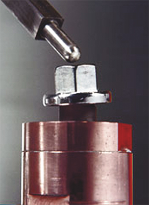

dophin nose shape of this nut guide pin keeps the weld nut centrally located on the guide pin
The dolphin-nose shape of this nut guide pin keeps the weld nut centrally located on the guide pin. Air pressure holds the guide pin in the up position. When the upper electrode pushes the weld nut and guide pin down, air passes around the guide pin to blow a any weld spatter, help prevent the guide pin from sticking, cool the tooling and minimize electrode-cap wear.
