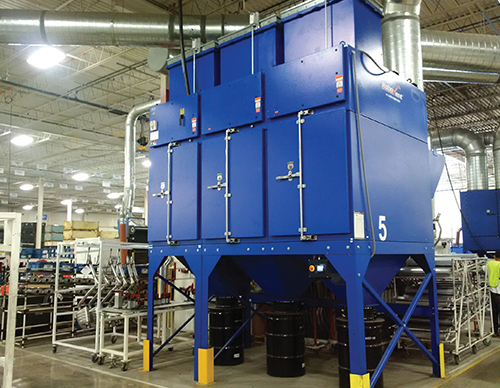

Today’s air-cleaning systems for metalformers and fabricators employ variable-frequency drives as well as other technologies to better handle exotic dust and fumes and keep maintenance and energy expenses in line.

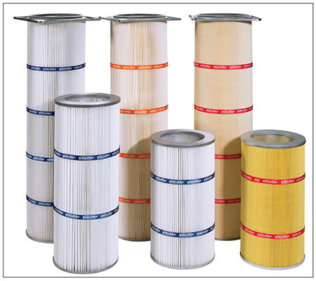

Frequency of filter changes correlate directly with the evolution of mists and particulates, according to Meyer.
“Because of the different fume and particulate, filters do not last as long,” he says. “Using traditional techniques filters may last six months now, whereas before they lasted for a year or two. On top of that, filters often collect hazardous material and must be disposed of via a hazmat process and transported to hazardous-waste landfills.”
Newer material grades and coatings introduce unique dust hazards and can play havoc with filters. A correctly designed air-cleaning system and improved filter technology help combat these developments.
Meyer and Frank Cea, director of marketing communications and development at RoboVent, provided an anecdotal cost breakdown of air-cleaner filter replacement. With filters typically priced at $1 or more per ft.3/min. a 10,000-cfm unit already sets a manufacturer out $10,000 for a new filter. Add labor and disposal, and total filter-replacement cost can reach $15,000 or more, especially if hazardous-waste removal and disposal are needed. Replacing filters two to three times more often than previously typical quickly escalates air-cleaning expenses.
But dirty filters are not an option. Clogged filters force air-cleaning systems to work harder, leading to energy inefficiency, diminished effectiveness and more. That means extra costs for maintenance and repair, and higher electricity costs. Uncaptured dust settling in ductwork heightens the risk of combustion, while cleaning ducts often entails paying specialized contractors to remove the dust. In addition, inhouse maintenance personnel, instead of focusing on maintenance and repair to keep processes and equipment running smoothly, spend time and resources on air-handling issues. Ineffective air cleaning also leads to higher lighting and heating costs, according to Meyer.

Newer technology enables these improvements. For example, variable-speed drives in air-cleaning systems provide energy-efficient options for supplying needed power. A standard industry formula, the air-power equation, provides a rough measure of the cost to run a motor for air flow. The formula: 40 x brake horsepower x number of hours operating the fan x cost per kwh. Here, the variable is brake horsepower, explains Meyer.
“You can vary brake horsepower using a variable-frequency drive (VFD),” he says. “A VFD uses just enough brake horsepower to effectively capture the dust.”
Thus, VFDs decrease energy costs while reducing strain on system components, making them game changers, according to Meyer, who notes that RoboVent employs VFDs on 95 percent of its systems, save for the smallest units.
“Instead of designing an air-cleaning solution for a worst-case scenario where it works way too hard when filters are clean and costing a company money due to high electricity usage, or running a fan so slowly that it only captures dust well at the beginning but not as the filters fill up, a VFD offers the ideal setup,” Meyer says. “The proper design for cost control as well as employee protection: a VFD that always pulls the correct amount of air to capture contaminants.”
Filters also benefit from technology improvements, which deliver increased filter life.
“For example,” Meyer explains, “inert microscopic materials injected into ductwork absorbs oils and certain chemicals so that they don’t adversely affect the filtration media.”
