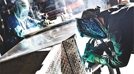

Parts produced at Quality Industries
Parts produced at Quality Industries are assembled for delivery to customers in industries including heavy transportation, alternative energy, electrical enclosures, and towing and recovery equipment.

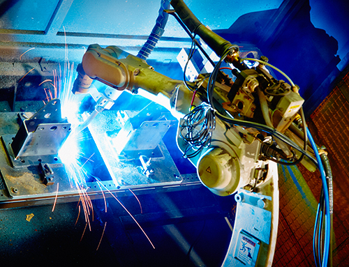

One example: the addition of a Panasonic dual-robot turntable using welding equipment from Miller Electric. Previously, tack welds provided by human welders held parts together for welding of the assembly via an older robot. Testament to the company’s forward thinking, engineers developed what they refer to as “no-tack fixtures” to work in conjunction with the dual-robot setup.
“Now we load the fixtures and the robots perform all of the welding,” explains Fann, noting that as the dual-robot cell welds, personnel load parts into a second fixture for welding as soon as the previous assembly is completed. “This setup has allowed us to greatly increase capacity for the solar product.”
That cell was tailor-made for processing thicker steel, according to Ken Ham, Quality Industries’ vice president of engineering and technical services.
“The water-cooled, higher-amperage torches use large-diameter flux-cored wire, allowing us to run a faster welding rig than is possible on some of the other equipment we have here,” Ham explains.

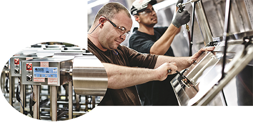

powder coating line at Quality Industries
Besides robotic welding, Quality Industries’ capital program includes investment in a new powder-coating line (right), CNC punching and laser-cutting machines (top), stamping presses and more.
Seam-tracking technology improves quality and productivity in this cell.
“We deal with a lot of part variation,” Ham says. “A single assembly, made from two L-shaped brackets, requires 32 in. of weld. The brackets mate to each other, and when angles vary, even just a little, from bracket to bracket, we would have to perform a large amount of rework. With seam-tracking, the torches find the joint even if the angles vary by 1 deg., and stay dialed in to perform good welds.”
