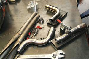

Uniform Welding Pipe After Pipe
| Each fabricated pipe must be identically placed in the fixture in order to perform in exactly the same manner. The high-speed pulsing feature of Big Gun’s new welding machine constricts and focuses the arc, allowing operators greater control over arc stability and heat input, allowing parts to stay cool and avoid warping. |

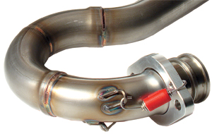

In terms of welding alone, the Dynasty helps Big Gun achieve uniformity because, among other things, operators have more heat-input control, according to Frank Sison, head of manufacturing at Big Gun.
“The crucial part of welding is not getting material hot to the point where it changes shape and doesn’t fit in the fixture,” says Sison. “With the Dynasty, I get a finer bead so the part stays cooler and doesn’t warp.”

“You get exactly the right-sized bead as you weld it,” says Sison. “And you don’t need to go over it and make it look pretty, because it’s pretty the first time.”
“Our welds look like they were performed by a robot, but are better because they are so flawless,” says Young, agreeing with Sison on bead appearance. “The fabrication is so clean, and everything has been deburred so well that it’s smooth, which is important because burrs can kill the power.”
