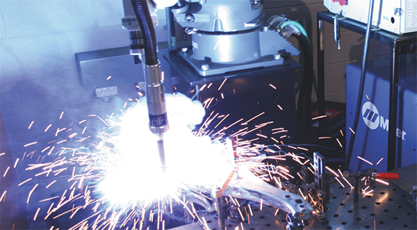

Metal-cored weld wires are tubular —a metal sheath filled with metallic powders, alloys and arc stabilizers. As opposed to solid wire, metal-cored wires carry higher current densities (at equivalent amperage settings), allowing increased weld-deposition rates. Because of the fast travel speeds these wires allow, they often get the call for robotic-welding applications.

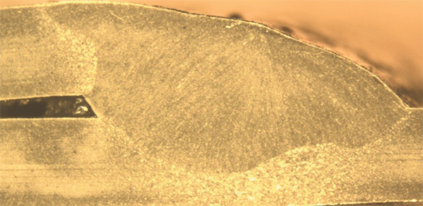

Recent advancements in metal-cored wires, specifically those carrying the AWS classification E70C-GS, provide significant advantages when welding hot-dipped galvanized steel. These wires feature formulations that allow them to weld with straight polarity (direct current/electrode negative). Operating in straight polarity offers two distinct advantages on galvanized steel:
• Softer arc penetration, which helps to prevent burnthrough on thin-gauge material and creates an improved penetration profile (Fig. 1); and
