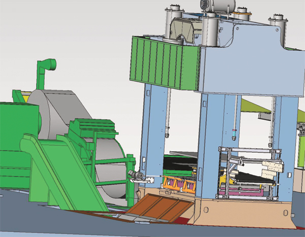

Miller Electric’s new press line features innovative scrap and part-out conveying solutions. Scrap will be funneled off the rear of the press (left) through a trap door in the floor, where a steel hinged-belt cleated conveyor awaits to move scrap a from the press and then up and out of the floor to a bin. The job of moving stamped parts out of the press will fall to a belted conveyor (right) that includes imbedded magnets in the drop area to avoid part slippage and allow rapid conveyor acceleration. To allow quick changeovers, the conveyor can slide in and out to accommodate a range of die sizes, and its tail pulley can easily (and tool-free) be raised and lowered to match die height.

The scrap-handling solution developed by TCR for Miller Electric’s new press will funnel scrap off the rear of the press (see the CAD-model screen capture) through a trap door in the floor where a steel hinged-belt cleated conveyor awaits. The conveyor, which sits in a 3-ft.-deep pit, will move scrap a from the press and then up and out of the floor to a scrap bin. The floor section of the conveyor acts as an accumulator, which will allow the press to continue to run while the conveyor pauses momentarily each time a fork-truck driver exchanges scrap bins.
To move scrap from under the die and out onto the conveyor, TCR specified a mechanical press-mounted scrap shaker (a Shuffle Drive unit from the Press Room Techniques division of Mayfran) driven by an electric motor. As explained by TCR president Todd Wenzel, “compared to air shakers that employ linear back-and-forth motion, the Shuffle Drive creates rotary motion, rocking the crossbar on large pillow-block bearings of UHMW plastic that minimizes noise levels. And, the trays attach without the use of tools, minimizing setup time.”
Another benefit of the Shuffle Drive, says Wenzel, is its crossbar-shaft design that isolates off-center loading from the scrap trays a from the motor. “As a result,” says Wenzel, “all of our customers using the shakers experience very few if any maintenance issues.”

The job of moving stamped parts out of the press falls to a 42-in.-wide by 96-in.-long belted conveyor from QC Industries, rated to 233 ft./min. The conveyor was specified wider than the press’s Coe feed line “to handle larger stampings such as case wrappers and doors, and so that the conveyor would not be a bottleneck for future parts,” says Wenzel. Conveyor features include a cut-resistant top, a stainless-steel frame and imbedded magnets in the drop area to avoid part slippage and allow rapid conveyor acceleration for speedy part removal.
Flexibility is key to the custom design of the conveyor setup, to ensure quick changeover while accommodating Miller Electric’s wide range of die sizes and shut height. “Using the press to stamp everything from small brackets to large wrappers and door panels,” says Miller Electric designer/ drafter Jim Dimpfl, “we’ll run some 20 dies through the new press ranging from 22 by 34 in. all the to 36 by 86 in. And shut height will vary from 12 to 17 in.”
To allow press-setup technicians to quickly change the line over, TCR engineered the conveyor’s mounting system to allow it to slide out of the bolster area to accommodate longer dies while allowing it to extend into the die area to reach shorter tools. The mount also incorporates a pivoting mechanism so the setup technician—no tools needed—can raise and lower the tail pulley to match die height.
