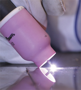

6] Are there any recommendations for optimum torch angle when welding?
Welders should position the GTAW torch nearly perpendicular to the weld joint. The most common technique is to tilt the torch back about 15 deg. and push the weld puddle along the joint. This technique results in a symmetrically round weld puddle that concentrates the heat.
Proper tungsten-grinding procedure (lengthwise rather than
circumferentially) protects against arc wandering, which can increase heat input to the base material.
As with all welding, the key to obtaining good, consistent weld quality is finding a comfortable position. While most welders will determine the optimum technique that affords the best torch control, they should position their bodies to allow them to clearly see the weld joint and the tip of the tungsten electrode. They should keep the tip approximately 1⁄8 in. from the base material. This helps maintain a consistent arc length and prevents arc wandering, which could increase heat input to the workpiece. A consistent 1⁄8-in. gap from electrode to workpiece also helps maintain good shielding-gas coverage and allows visibility of the weld puddle, to help the welder control travel speed.
