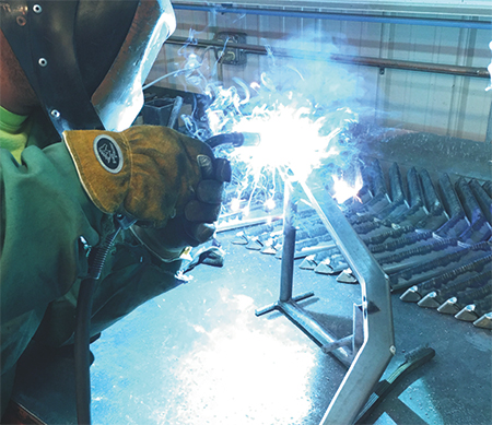

Transfer from GTAW to wave-pulse gas-metal-arc welding (GMAW) welding of aluminum components, which comprises about 90 percent of its welding tasks, has enabled Skinz Protective Gear to cut production time in half and reduce labor costs. “(Our) welders particularly like how easy it is to change settings for different parts, and that the gun is easy to articulate,” explains Jake Hawksworth, who runs the company’s Paynesville, MN, production facility. |

Through the use of pulse-wave gas-metal-arc-welding technology, Skinz has experienced eased setup and high quality when welding aluminum for snowmobile aftermarket parts such as this front bumper. |
