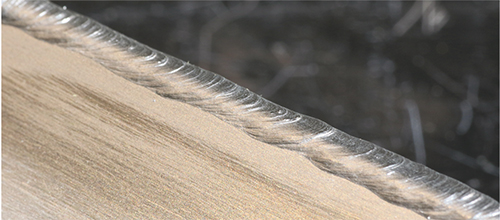

A 0.039-in.-dia. electrode provides the flexibility to bridge gaps, weld thin sections without burnthrough (such as this 1.5-mm plate) and offers the ability to increase deposition rates and travel speeds on thicker material.

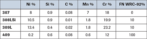

Fortunately, the high-silicon 300-series austenitic steels can be used to weld ferritics in many applications having a more fluid weld puddle and a better ability to bridge gaps. As a result, gas-metal-arc-welding (GMAW) electrodes based on 300-series grades (see Table 1) provide better weld appearance, less rework and faster travel speeds. In addition, using an austenitic filler creates a favorable microstructure in the weld metal, helping combat the tendency of grain growth in ferritic steels while improving mechanical properties.
Table 1—The high alloy content of 309 and modified 307 stainless steels make them suitable for joining 400-series stainless steels and dissimilar grades of stainless to carbon steel.

The downside of filler metals such as 309L is that the higher nickel content makes them more expensive. In the eyes of some original-equipment manufacturers, pennies per pound matter. As a more affordable alternative, consider a modified 307 electrode with increased manganese content. Less costly than nickel, manganese acts as an austenitizing agent to create the right microstructure in the weld metal and at a price point similar to that of a 308 filler.
A full-penetration corner weld on 1.5-mm stainless made with a 0.039-in.-dia. modified 307 electrode and using the GMAW-pulsed process.

Modified 307 electrodes are available in conventional North American diameters, as well as the 0.039-in. (1.0-mm) dia. more commonly used in Europe. For all but the thinnest sheetmetal applications, a 0.039-in. electrode provides an optimum balance of properties. Although just 0.004 in. larger than a 0.035-in. electrode, it can provide increased deposition rates and/or travel speeds, yet run at parameters (60 to 140 A, 15 to 21 V) that overlap all but the low end of an 0.035-in. electrode. With less-than-optimal fitup, a larger-diameter electrode will provide 20 percent more fill and help bridge gaps, and do so without risking burnthrough.
